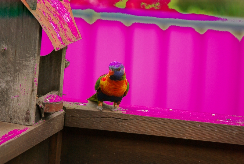

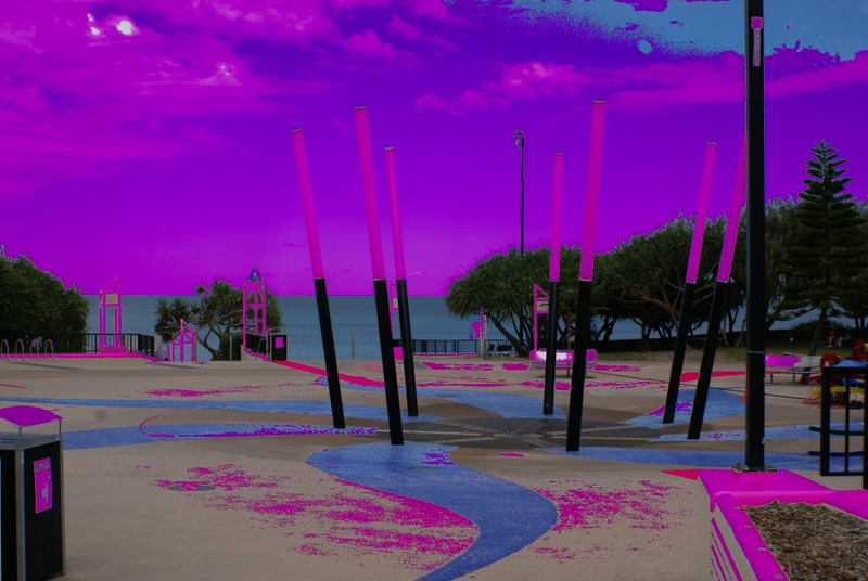

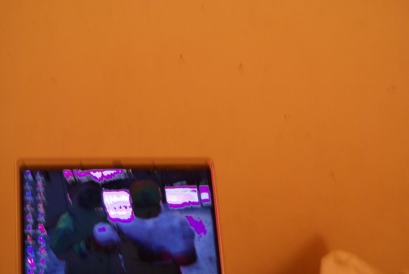

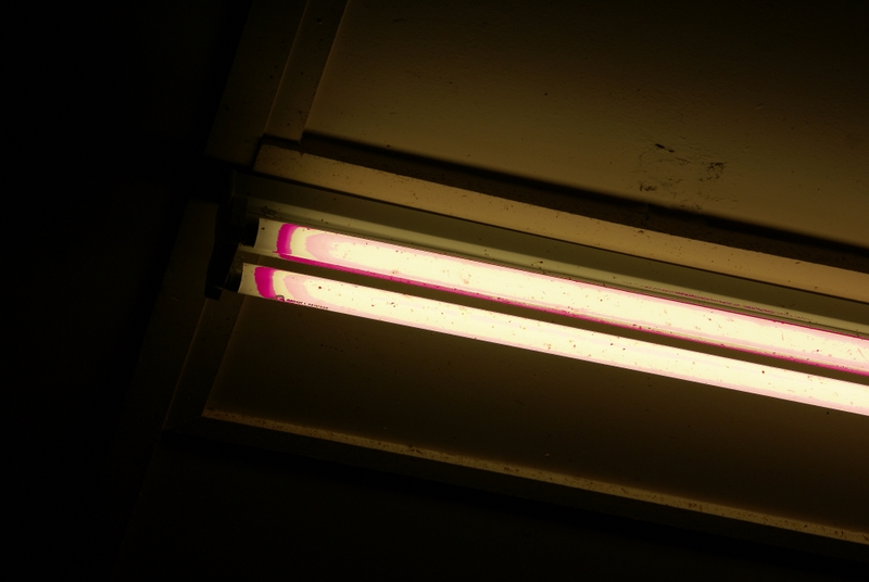

here are some pics if I can get them uploaded
[Image: 35_DSC05351.JPG]
[Image: 40_DSC05377.JPG] [Image: DSC05445.JPG]
[Image: 93_DSC05444.JPG]
[Image: DSC05439.JPG]
[Image: DSC05438.JPG]

That's pretty severe. If a new sensor doesn't cure it, maybe its something in the display configuration.
What I am seeing in these photos is that the pink effect seems to correspond in a lot of cases to specific *bright* areas of the photo (photos 1 and 2 are good examples). This looks suspiciously like the "Display Clipped Highlights" option that is available on the A-100 Image Data Converter edit program. Here is a link to a description of it including a screenshot.
http://www.dpreview.com/reviews/sonydslra100/page18.asp
Sorry - I can't be of more help - but I would start by looking at that who you have that option configured.
