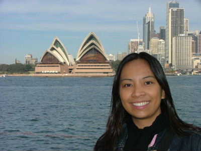

Hi, just having a little problem with shooting in strongly backlit locations, and would like some advice.
A) Ok here's the shot with the normal metering, so the camera averages the scene, and darkens the exposure to compensate.
Result: subject is too dark to distinguish features
[Image: DSCF1947.JPG]
B) So I turn on spot metering, and measure the light off the subject.
Result: subject is correctly exposed, but the background is washed out and too bright
[Image: DSCF1948.JPG]
C) Racking my brains, I turn on fill flash.
Result: everything is exposed correctly, but the subject looks like she's been artifically pasted/photoshopped into the scene.
[Image: DSCF1950.JPG]
What's a man to do? Sad

She does look pasted in indeed, (you're sure she isnt? Big Grin ). I'm a bit puzzled myself, though I expect it is a simple answer that you and I are both overlooking.
If I should figure this one, I'll obviously let you know.
Regards,
R.
Though maybe, (said he, thinking aloud), it's simply the difference in focus. Normally an image tends to have foreground, background, and a little bit of most in-between. This, conversely, is a sudden transition from near to far. If this idea is right, then;
1/ Use a smaller aperture
2/ Use a shorter focal length
3/ shoot from a little further away from the main subject, (thus changing DOF).
Plus, of course, the flash presents a rather flat light, in contrast to the background, which also exaggerates the effect.
Maybe.
HTH
R.

I think the composition is important too... are you trying to capture the person or the scenery? If you are trying to capture the person, then Rufus idea of changing is a great one.
In economic there is the great theory of opportunity cost. The art of composition is similar. Do you fit everything in and get a mediocre result? Or sacrifice some of the background?

AE lock on the background then take. Subject may be underexposed, but you can fix that when post-processing, provided that not too underexposed otherwise it becomes noise.

Keeping in mind I'm new at this, here's my thoughts on this problem... (nothing like reviving a seemingly dead thread!)
I've found that while spot metering is very useful, one must be careful where one is aiming! For example, in the above photo, if the spot was aimed at the clothing, which is darker, it will over-compensate. If, however, the spot was on the face, which is lighter, you may get a better exposure... Reverse is true when your subject is wearing light clothing (white t-shirt) - spotting on the body will result in an under-exposed photo and, again, spotting on the face will result in a better exposure.

Thanks for the tip Cailean... I'll try to spot meter on a more neutral object next time... Big Grin
