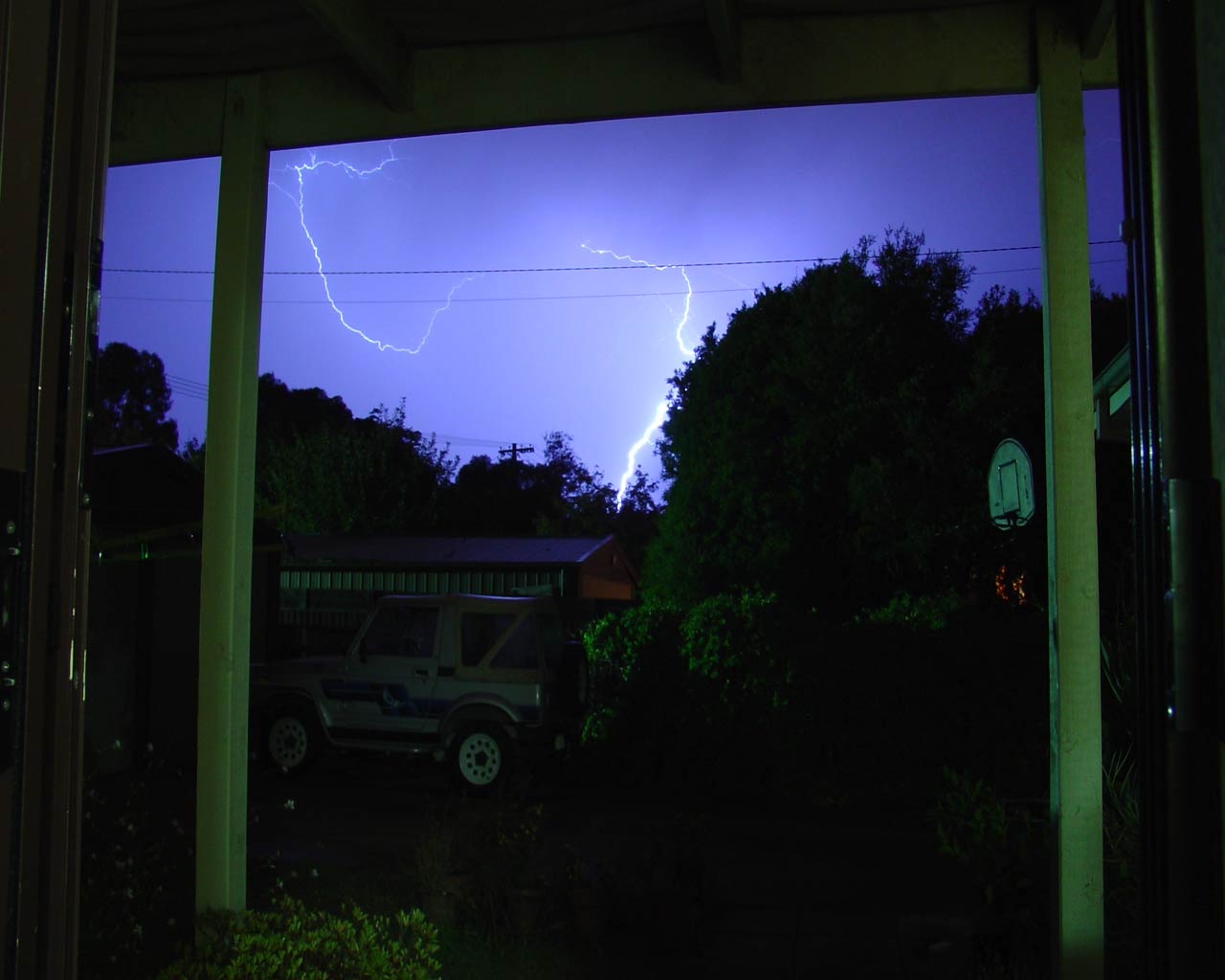

My tip would be to try to stay away from other existing ambient light - e.g. street lights or buildings, otherwise the lightning won't be as bright.
I took some out my back door some time ago, use similar technique to shooting fireworks.
B setting if you have it or long (30secs), low ISO, infinity focus (manual), aperture depends but not stepped down too much, try F8 to start with.
[Image: Lightning2.jpg]
