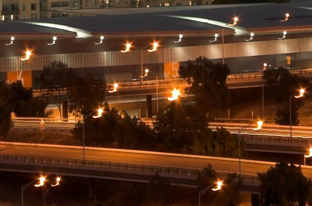

Here's a crop from a picture I took tonight.
[Image: unstable.jpg]
The camera was on a tripod (I wouldn't do a 10 second handheld exposure even with IS Tongue).
To me, it looks like camera movement, but I was using a tripod.
Could it possibly be caused by camera vibrations from the mirror flipping up (a need for mirror lockup?)
Or I've read that when using a long lens, to rest your hand on the top of the lens to stop vibrations, when it's on a tripod, but I was using a short lens, so didn't do that.
Or good excuse to get a new tripod (which is on its way! hopefully)
Sometimes it's a good idea to use the self timer for long exposures. If your tripod is not really rock steady, the push of the button can cause camera shake already.
Hey Adam,
I always try to use a remote or self-timer for shots like that for exactly that reason. When you press the shutter button invariably you squeeze the camera down onto the tripod head, moving it just a little bit. Self timer is annoying, but wireless remote is great (haven't tried wired remote). Remote is pretty much essential for doing any "bulb" work (with wireless remote, you press once to open shutter, then press again to close it).

I may also agree with the theory of camera shake. The photo doesn't really look all that crisp. What camera do you shoot with again Adam? Is it the 300D? If so there is a tutorial available to build a wired remote that works great and very cost effective. I use a home made unit myself.

I usually use the 2sec timer on tripod.

hmmm... have you ever considered that the shake was caused by the vehicles passing by and vibrating the platform? one way to minimise this would be to get a sturdier tripod or weigh down your tripod to make it more stable.
the tails look very small and indicate very small vibrations.
I never thought of that possibility!
