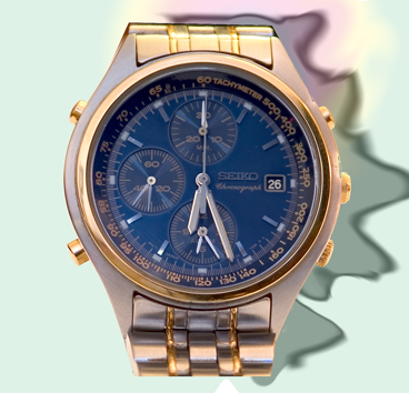

OK, I can layer, apply fx's etc, but now I'm stuck again! :/
Take a lens, for example:
Nice shot of lens, cut from BG, applied to fake paper BG and shadowed. Easy.
BUT. :/
Suppose I want to effect that shadow to bend it, or, more likely, give the impression of a shadow created by a specifically placed light source. The drop shadow layer adjustment will only re-position the whole shadow! :x
Now I see the liquify or distort filters will do this no prob, but my shadow is on the layer WITH the lens pic! :o Can I shadow to a new layer? How? :/
Is there a way that I'm missing here??? :/

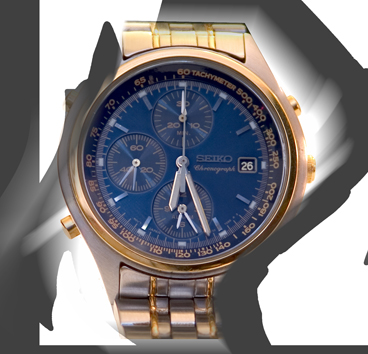

I tried this image of my watch. :o :o :o :o :o
Eeek!
I stuffed up sorry, can't for the life of me remember how I've done it before but I thought that was it. You can flatten it and copy the shadow and paste it back into your image as another layer and make the solid white transparent in layer properties but it might make the shadows weird.

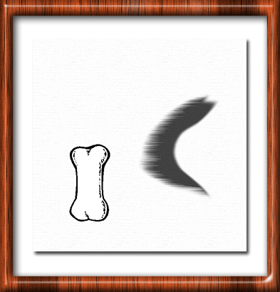

Rufus: When you have your drop shadow layer effect, rightclick the effects row in the layers window and select "Create Layer". This will create a new layer with just the shadow.
Hope this helps, my copy of PS is in German and I'm never quite sure about the English terms.
Genius!
I'm sending you a present!
![[Image: bone.bmp]](http://www.shuttertalk.com/forums/images/upload/bone.bmp)

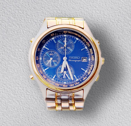

![[Image: Untitled-2-copy.jpg]](http://www.shuttertalk.com/forums/images/upload/Untitled-2-copy.jpg)
Is this sort of what you're trying to do?

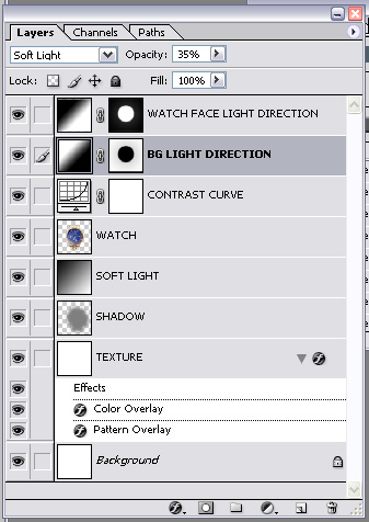

Here are the steps I used:
Pretty simple stuff. The tough thing to do, given the way the watch is lit, is create realistic directional light.
The shadow part is very easy. Do NOT use the drop shadow layer effect. Select the watch, create a new layer, fill in the selection with black, blur it, go to edit>distort and move it around, and adjust opacity. I added the soft light layer to even it out a bit.
Edit: I forgot to change the light direction on the bg! LOL.
Edit #2: You CAN use the drop shadow effect as long as you put it on a separate layer as Guerito suggests. Then follow the rest of the steps.
Guerito - that's a great tip. I learned something today!
