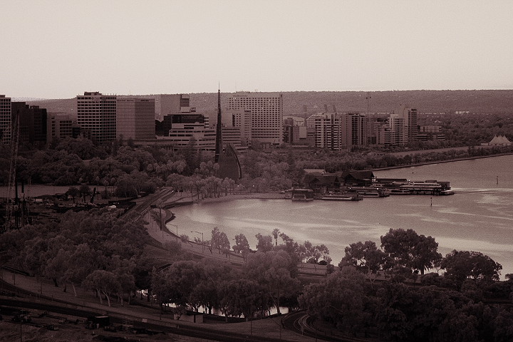

This picture is one of the only good ones - a 30 second exposure without a tripod - it was lying on my camera bag
![[Image: IR%20Perth.jpg]](http://www.shuttertalk.com/forums/images/upload/IR%20Perth.jpg)
Hey that looks great Adam. Lovely clouds.
There does look to be a faint hotspot, but it is so spread out that its not really noticable. I'm sure if you tweaked the white balance and saturation you could make it disappear, as it looks like it saturates the centre of the image slightly rather than lightening it (which the kit lens does).

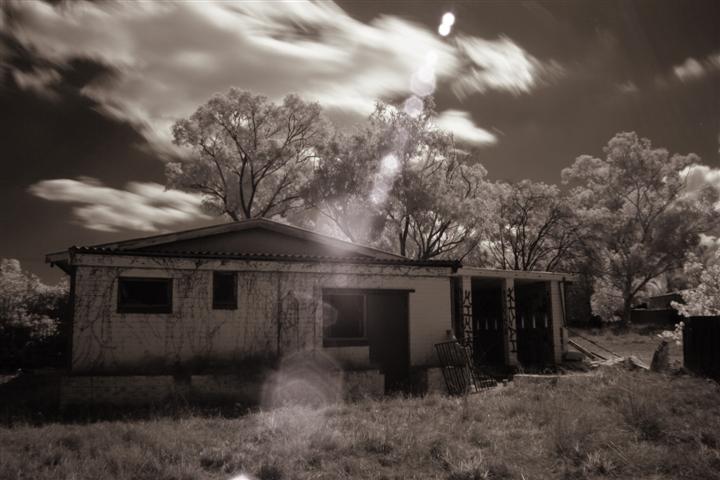

Here's an IR shot I took with the kit lens the day after I got the camera. It came out OK, but check out the masses of lens flare. I think I took this exact same photo without the R72 filter, and none of that flare was visible. The sun was a fair way above the edge of the lens (but I wasn't using a hood).
It still doesn't have a very pronounced IR effect to it though, but its better than nothing (the contrast in the sky is nice, and the trees are a bit lighter). :o/
