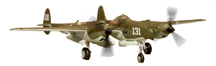

ooo.. nicely done G!
Rufus, G seems to have the moving prop side of things sorted, but here are some other tips I can think of:
