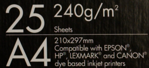

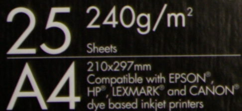

All these are at 100% crop focused on the "R" in "HERE"
Canon EF 50mm f/1.8 @ f-5.6 and @ f-8
[Image: CRW_0489prime56.jpg][Image: CRW_0490prime80.jpg]
Canon EF 28-135mm f/3.5-5.6 @ f-5.6 and @ f-8
[Image: CRW_0493is56.jpg][Image: CRW_0494is80.jpg]
Canon EF-S 18-55mm (300D kit lens) @ f- 5.6 and @ f-8
[Image: CRW_0491kit56.jpg][Image: CRW_0492kit80.jpg]

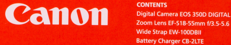

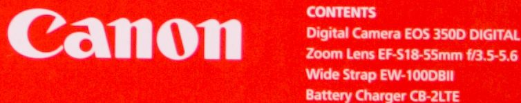

The first results here are trying to replicate your test.. high contrast red/white text smack in the middle of the image at 50mm focal length and a few feet away. I even used my desk with monitor behind it ( Tongue ) but my desk is messier than yours Rolleyes Camera was mounted on a tripod and I used a remote shutter release (but didn't bother with mirror lockup).
[Image: IMG_3419.jpg]
Here are the results... note that I took all shots in RAW and then converted them using Adobe Camera RAW with the sharpness and noise reduction set at zero... so they have no in-camera sharpening or PC sharpening applied to them at all.
First up, 50mm prime lens at f/5.6 and then f/8.0:
[Image: Crop_IMG_3418.jpg][Image: Crop_IMG_3419.jpg]
Next, 17-85mm at f/5.6 and f/8.0:
[Image: Crop_IMG_3421.jpg][Image: Crop_IMG_3422.jpg]
And finally the 18-55 kit lens at f/5.6 and f/8.0:
[Image: Crop_IMG_3423.jpg][Image: Crop_IMG_3424.jpg]

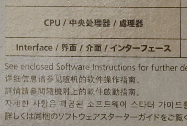

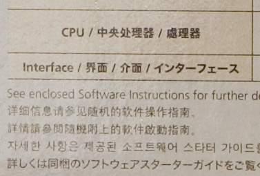

So I set up another test with contrasty detail in the corners and everything on the same focal plane (using the bottom middle focus point to focus on some black text on the grey box), and then used the same lenses to basically do the same test as before.
Here is the overall shot:
[Image: IMG_3434.jpg]
And here is the bottom-left corner using the 50mm prime at f/5.6 and f/8:
[Image: BottomLeft_IMG_3433.jpg][Image: BottomLeft_IMG_3434.jpg]
The same crop with the 17-85 lens at f/5.6 and f/8:
[Image: BottomLeft_IMG_3431.jpg][Image: BottomLeft_IMG_3432.jpg]
And the 18-55 kit lens:
[Image: BottomLeft_IMG_3426.jpg][Image: BottomLeft_IMG_3427.jpg]
A huge difference. While the 50mm prime and 17-85 hold together nicely at the edges (the 50mm still way better), the kit lens turns to slush. Strangely, the f/8 result seems even blurrier than the f/5.6 result. I quick comparison of 100% crops of the part of the image I was focussing on shows that the problem seems to be that the kit lens simply didn't focus correctly. If this is the case, it simply highlights the better focussing of the other lenses, or perhaps that the camera struggles to focus through the edges of the kit lens (which I suspect to be the case - often the kit lens seems to only lock focus when using the centre focus point).
Here are 100% crops of the area where the camera was (supposed to be) focussing on:
[Image: BottomFocusPoint_IMG_3433.jpg][Image: BottomFocusPoint_IMG_3434.jpg]
17-85 at f/5.6 and f/8:
[Image: BottomFocusPoint_IMG_3431.jpg][Image: BottomFocusPoint_IMG_3432.jpg]
18-55 kit lens at f/5.6 and f/8:
[Image: BottomFocusPoint_IMG_3426.jpg][Image: BottomFocusPoint_IMG_3427.jpg]
