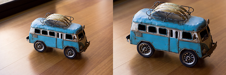

Firstly, a comparison shot to see the magnification difference the 1.4 teleconverter makes. Both of these shots were taken from the same spot with the EF 50mm f/1.8 lens @ f/2.5 (which was wide-open with the teleconverter). Can you pick which one I used the teleconverter with? Big Grin Big Grin
[Image: 50mmWithAndWithout.jpg]

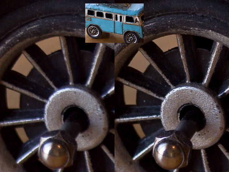

For the next test I used my 70-200 f/4L lens (running at f/5.6 so I could use the same aperture with and without the teleconverter). In this scenario I positioned the camera on a tripod and took one shot at 100mm without the teleconverter, then the same shot at 70mm with the teleconverter to give the same equivalent focal length (70 x 1.4 = 98mm). This image shows 100% crops of the centre of the image, with a little inset pic showing what the whole photo looked like. Can you see any difference between the shots? The only differences I can see are very very minor, and could be accounted for by slight vibrations through the tripod or differences in focus. I was very impressed with these results.
[Image: 100F56v70F56CenterTest.jpg]

Remember these are 100% crops (the inset shows the whole shot), and to be honest this corner example with the teleconverter is still noticably better than the corners of my EF-S 17-85 when it is at a fairly wide focal length.
So is it better than the Canon teleconverter? Well.. I've never used the Canon converters so I'm stabbing in the dark a bit here...
But I'd expect the Canon to have better quality at the edges, but really I can't see how the Canon could improve much in the centre of the frame because the Kenko seems extremely good there.

I'm cut... by the sharpness of your 135 f/2L at the corners Tongueheheh
Thanks for showing the results of the test Kombi (of a Kombi!)
The results of the Kenko teleconverter look perfectly acceptable to me; The degradation in quality is not obvious unless I'm looking at the 100% crop closely; (most of the time I resize my pics to post on the web anyway Big GrinBig Grin) and not knowing exactly how much I'll have it on, it's probably better that I go with the cheaper Kenko than Canon. The price difference to me, is very big and I'm not sure that I'll pay so much more if the Kenko's already quite good.
