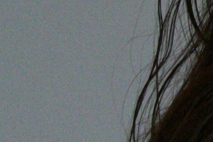

[Image: giuseppina%20wall%20600.jpg]
a 100% crop of the wall, the noise level is horrific.

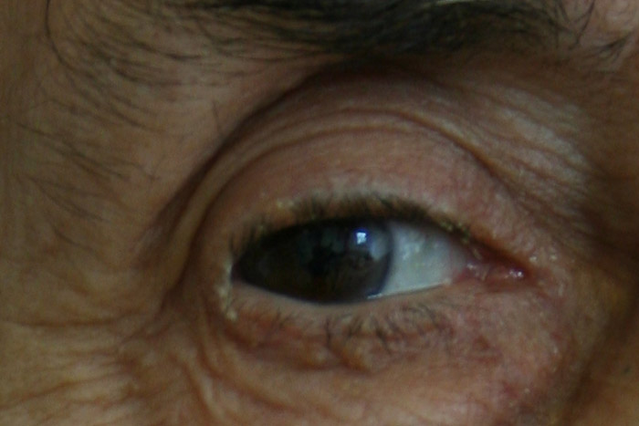

[Image: giuseppina%20eye1600.jpg]
And her eye is so out of focus, that the shot is worth nothing.

[Image: giuseppina%20wall%20200.jpg]
the wall again just to show the - much more acceptable - noise.
[Image: giuseppina%20eye200.jpg]
and even though I find her eye is not as entirely in focus as I would have liked it to be, this is uncomparably better than at 1600.

A couple of thoughts, without any real knowledge to back them up:
The eye is in shadow, so perhaps Canon's built-in noise reduction is reducing the detail; and
Is there a chance that the eye was too low contrast for the AF to lock accurately, causing backfocus? (No, I don't know why this might happen at high ISO, but not low ISO.)
I think Matthew is onto something with regard to the noise-reduction Uli.
I strongly suspect the camera (or RAW converter) really pumps up the noise-reduction to try to keep noise under control at 1600 ISO.. and the most common side-effect of any noise-reduction is a softening of the image.
While the 350D generally handles noise pretty well up to 800 iso (compared to other DSLRs of the same age and budget), there seems to me a huge difference between 800 and 1600. No wonder you can't push the 350D to 3200 iso like you can the 20D.

...that's why I was thinking that it was noise processing smoothing out the detail in the eye. There's plenty of sharpness in the stray hair, where it's very high contrast against the wall, but little per-pixel colour variation.
I think that's pretty much nailing it down, a little bit of poor focussing abilities, bad light,
and the noise reductions. That's such a smart thought, I would not have guessed. I wonder what the pictures would looke like without the noise reduction......
