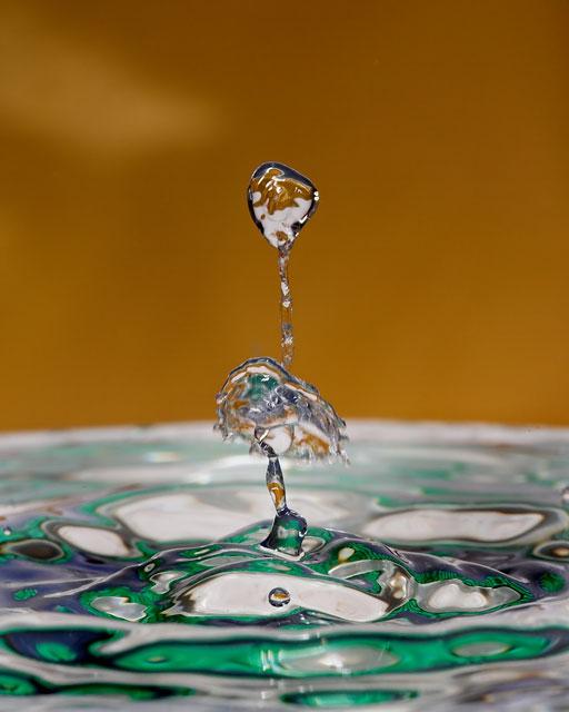

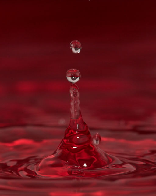

I spent the weekend taking pictures to water drops and trying to get the splash... I haven't got it right so far, but I thought I would like to show you what I am doing in case you have any advice to improve my pictures.

I like #2, Irma the colours look amazing.

great shots there Irma, #2 and 4 would be my favs. very close to the mushroom on 5 Cool

Thanks so much for your comments Smile I am very surprised and very happy that you like #2... because I have a lot of them with different colors and shapes... I thought you wouldn't find it interesting...

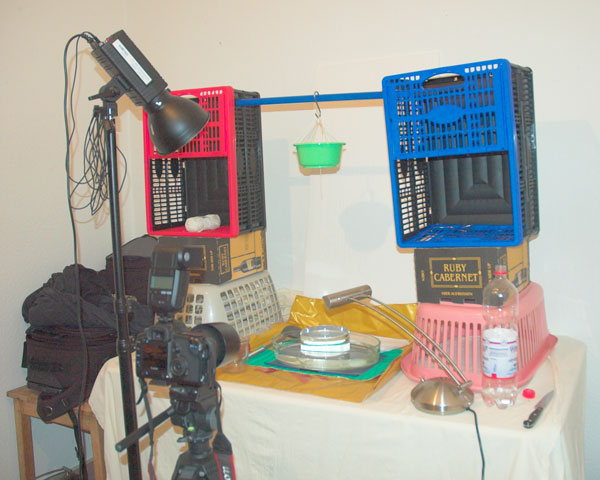

Sorry I didn't give any comment yesterday setup, settings, etc...
About the setup.
I built it with things I had at home here is the picture... I doubted to post a picture because of the rudimentary of the setup, but the description was very long. I am sure that it will give a good laugh to you all, but I really didn't want to spend money on this until I knew there were some possibilities...
Smile
[Image: DSC_7568-01setup.jpg]
All this to get a constant drop falling in the same place and the right timing to match the one coming up with the one falling down.
Problems I have is that the speed of the droplet is not constant because the dripper gets slower at the time it has less water but as you know it already you just need to refill it to get again the splash.
I will change all my set up and I will replace everything for the ironing table and a more sophisticated dripper made by a bottle and a pastic straw... I will tell you later if it works.... Smile
My settings in the camera. My best results so far for the splash and with the available light I have are: f/16, 1/6400sec. ISO200. 180mm macro lens.
To get the droplet like in #2 with 1/2000sec and f/16 is enough.

I like #2 because the colours blend really nice. That is as well as the drops.Smile

I could name them as well.
#1 Vesuvius.
#2 Genesis.
#3 Medusa./.Jellyfish.
#4 Emu.
#5 Anemone.

Wow Irma, that is one cool setup you have there! That just made my day... thanks for sharing!
You won't think any thing so simple could look so cool.

Been lurking on the forums for some time now and have seen lots of your great photos. I have to agree with everyone else these are amazing. I have been meaning to try the same thing for ages, now that I have seen what is possible I am raring to go. Thanks for sharing your set-up looks like lots of fun. might have to rope in the girlfriend to help!

I love your setup IrmaSmile
Thanks Chris...
a bit embarrassing, ... so homely made.... Sad
