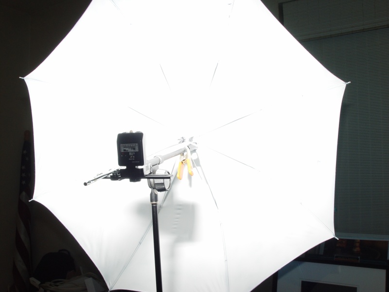

After returning home I assembled the rig shown, using a microphone boom-stand I had lying around (I have a lot of them, including one I use to hang up my laundry as I take it from the clothes dryer).

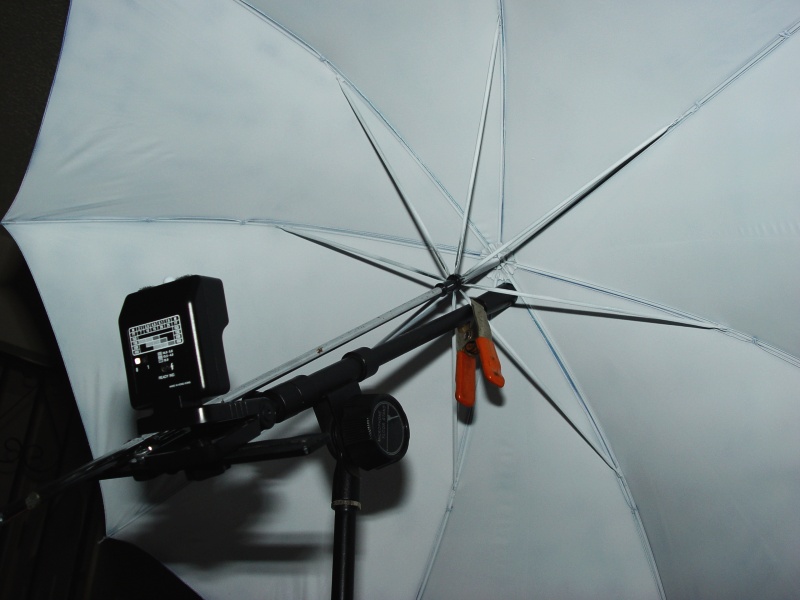

The flash is a cheap ($20) slave that I trigger using my hotshoe flash.
As you can see, it fully lights the umbrella and I can adjust the boom to place it farther away which will reduce the output a bit, as well as angle it in myriad different ways to get even more versatility.

There's some drawbacks compared to real photography gear, like a height limitation of 7-8 feet.
And the umbrella is "secured" by a spring clamp that might let go in a stiff breeze.
But everything used was already paid-for and laying about the house gathering dust, and now I have a complete umbrella flash system that works rather well according to my tests.
I did a quick portrait and a product shot, and the output is within my desired aperture range while the coverage is excellent, so I'm very pleased with my little project.
The umbrella is 1 meter across.
I plan on getting a Sunpak 383 Super manually adjustable flash soon, which will also attach to this stand perfectly until I can get a "real" umbrella for it, at which time this entire slave system will become my secondary fill.
I guess you can tell that I'm excited.
