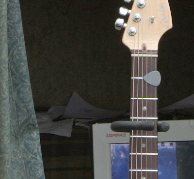

I just want to draw attention to its performance at 25mm f11, just as I find it interesting.
It's just from my test series and I'll let it make its own comments, in a sense.
Firstly, uncropped: a straight raw to jpeg conversion at standard, with a minimal amount of smart sharpening in PS:

Now a 100% crop from the centre:
[Image: 25mmf11crop.jpg]
And a 200% crop:
[Image: 25mmf11crop%20copy.jpg]
.73mm Dunlop nylon plectrum?
The lens seems to be doing well in the center, as shown here and in your other guitar posts. But how are the edges? That would be my "issue" with the lens, if indeed they are notably soft on a 1.6x camera.

Yes(which is the concern as we've said): here's its consistently least-good extreme corner at 100%, from the same shot, at the bottom left(my tests before this were with the camera in vertical):
[Image: 25mmf11%20rl%20corner.jpg]

Okay, back on topic: I would really consider sending it back for a replacement, or at least sending it to Canon for alignment under the warranty. As Wedding Shooter noted in a previous post, the soft corners can be fixed. I'd expect softness in the corners on a full-frame camera, but not with a 1.6x crop. You paid too much money. Just my opinion.
Would you call that 100% crop form the corner "soft" then, slej, compared to what one would expect at this magnification?
It's acceptable, but if we consider that it was taken at the middle of the zoom range at f/11, and it's been sharpened in post-processing, I wouldn't exactly call it crisp. Smile Also, everything in the picture is pretty much in the plane of focus, so it's not like you're at the extreme edges of the depth of field causing things to appear out of focus.
Take that shot with the aperture stopped down just a little bit from wide open, maybe a full stop to f/4, and compare. On a 1.6x crop, the corners should be nearly as sharp as the center with that lens. You mentioned possibly going to a full-frame camera - just think how soft the corners could be in that situation if they are already soft on one with a smaller sensor. The Mk1 version of this lens was highly criticized for its corner and edge softness, but the Mk2 should be much better.
Heck, the Sigma 18-50mm f/2.8 gave sharper corners on my 10D when stopped down that much. Other factors make the 16-35 a vastly superior lens, of course.
Anyway, it seems to me a minor inconvenience to either ask for a replacement lens, or to send it to Canon for calibration. I got excellent service from them when I sent the 70-200mm f/4L in for service; it was like a new and much better lens when I got it back.
Think of it as buying a high-end guitar that isn't properly intonated. It won't sound the way it should. But the potential is there, you just gotta get it tweaked. Unfortunately you can't do your own "set ups" on a lens, so send it off to Canon. Cool
Yes indeed: I'm actually in agreement witth you, as I've been aware of this.
I returned it to the retailer today for exchange(and got treated as if I were the one at fault, not the lens, by someone I found very hard to understand); once I "proved" that I was within my rights to ask for a replacement, rather than having to wait for Canon to get it to the state it should have been before it left them, I eventually managed to get the guy to grudgingly let me have one by next week. Ya'd have thought he was having to grind the glass himself.
