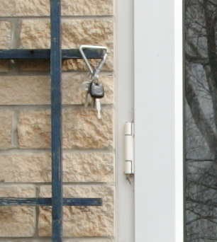

As the differences take some seeing at some points in the frame, here are some 100% crops:
Left-hand edges:
....at f2.8...
...and at f11...
You'll see, then, that f2.8 does remarkably well at this wide extreme.
Now, here are the centres:
You'd expect the f11 centre , even at 16mm, to be very creditable(and imagine how it looks at the "friendly" length of 24mm):
But here's the surprise as we see the same at f2.8:
Right then, this is enough pixel-peeping, I think I'd better go outdoors in the next day or so.
