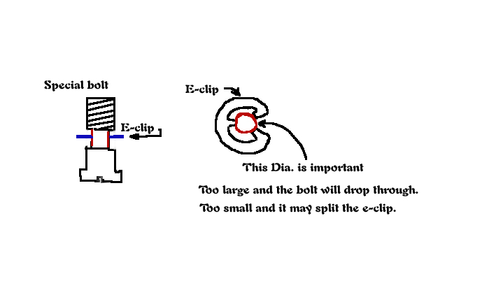

I used to work for an engineers merchants. E-clips is what they are called ( a type of circlip) and should cost no more then 50p sterling. You will need the diameter of the bit it fits on to or take it with you. I am sure you have engineers stores or hardware merchants in toronto.

[Image: 75_Untitled-1.jpg]
Thanks Matthew, NTNTNT
