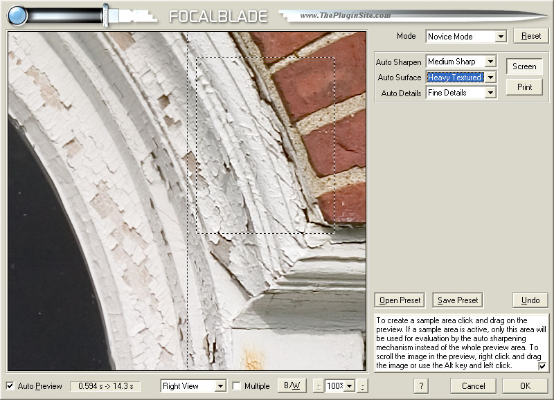

By default, the auto modes evaluate the entire preview area to set the sharpening levels. The auto modes can be made a little smarter by simply clicking and dragging the mouse cursor across a sample area. When this is done, the sample area will be the only area evaluated by the program.

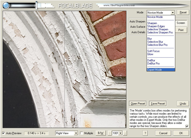

Pop down the “mode” button and you’ll see numerous alternatives to the novice mode: there are several “semi-automatic” modes in which you can sharpen only edges or surfaces, you can blur an overly-sharpened image, you can add a soft focus effect (one of the best I’ve seen, by the way) and more. Despite having played with FocalBlade for only an hour or so prior to running this test, I leapt straight to the last and most complex option: the completely manual “expert mode.”

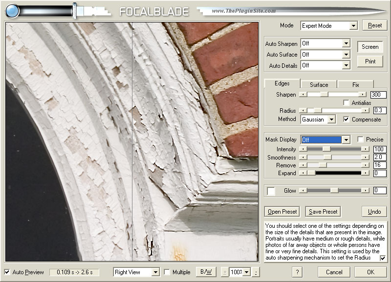

Note the three tabs labeled Edges, Surface and Fix. The first two allow you to set the amount of sharpening applied to edges and surfaces independent of each other. The Fix tab is a great feature that I’ll explain below.
As a control freak, the first thing I did was set all of the “auto” modes off.

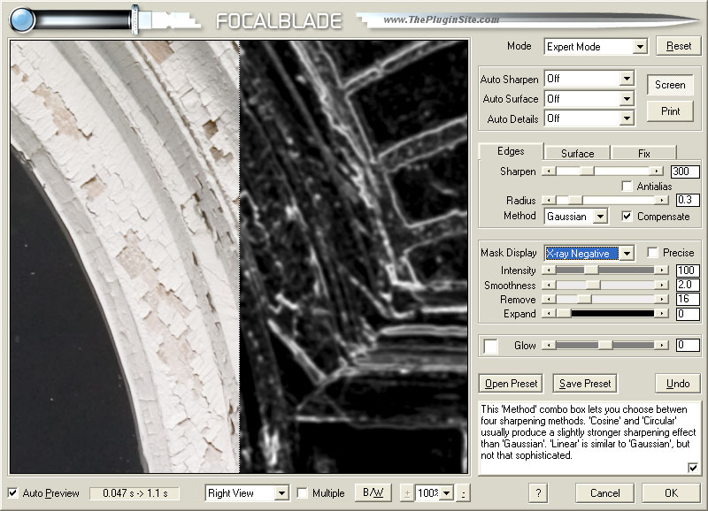

With Photoshop’s unsharp mask, I favor a high amount of sharpening applied with a very small radius setting, which seems to minimize haloing. So with the FocalBlade “edges” tab active I dialed in an amount of 300 and a radius of 0.3. (Note that the amount in FocalBlade seems less aggressive than the corresponding amount in Photoshop’s USM.)
One handy feature is the ability to see and control the edge mask:

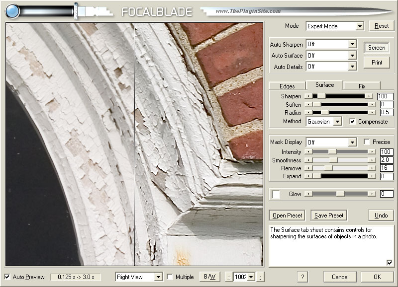

Next, I adjusted the settings on the Surface tab to my liking:

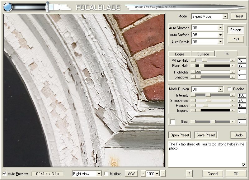

Initially, FocalBade does a great job of controlling halos. For complete control, switch over to the Fix tab where you can adjust reduce the halo effect to your liking by tweaking the white and black halos:
FocalBlade: Fix Tab
FocalBlade: Fix Tab
A simple click of the “OK” button and the process is complete. The end result is very impressive: edges are crisp with little to no haloing, and there does not seem to be any color noise.
